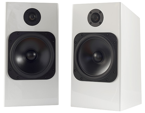

We have another candidate to talk about - maybe not worst, but for sure not that great either
with hilarious response from manufacturer, I think they do it properly - not arguing about some measurement details - but dismiss them completely ;-) .
• While we thank Stereophile for its efforts and of course Herb for this review, we rebuke traditional measurements, as no one is listening in an anechoic chamber and the need for excessive toe-in creates a narrow, nonideal, harder-to-enjoy listening arrangement.
This certainly an interesting approach.
John Atkinson does understand traditional loudspeakers and their goals. But this Totem Fire V2 is simply not a traditional loudspeaker.
Torrent Crossoverless Drivers are a huge step up in speed, transient articulation, and clarity without having control loss on the lower two octaves of music. This eliminates tone and clarity issues which invariably lead to harmonic inconsistencies higher up the frequency register. Without any reservations, the Fire V2 does not need either a crossover or specific time aligning via tilt- or low-pass filters, as our full analysis of FFT slices in the band that covers Torrent-to-tweeter integration is more than exemplary. Remember, this is the 21st century.
Totem Acoustic
