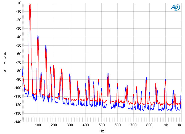

Interesting to compare with the Stereophile measured WA5:
https://www.stereophile.com/content...ted-amplifierheadphone-amplifier-measurements
This is only a headphone amp but it appears to also suffer from similar issues?
While the test are different, they definitely show very similar deficiencies:
That would be SINAD of 40 dB. The test tone is lower frequency so exaggerating the problem even more than my 1 kHz test tone.
It is a shame that JA uses such diplomatic words to describe this poor performance:
As a result, probably most people didn't realize how poor the performance was as reading the graphs with no reference is hard.
