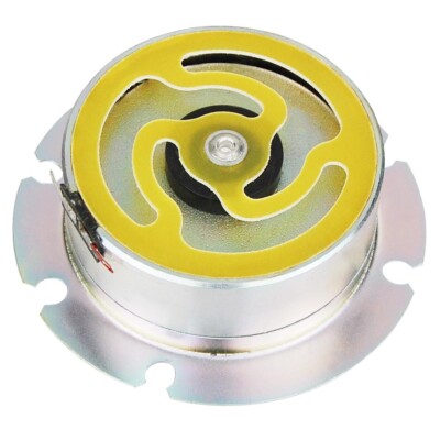

I bought this bass shacker and Id like to connect them to a BRU5.
Some question:
-is the ampli compatible with these bass shacker?
-can i use the BRU5 software to apply a band pass filter (22-55hz)
-what Is the Power supply needed?
Mamy thanks
Hi, and Welcome:
From the U.S. eBay Listing, I understand these come as a stereo pair.
1. Yes, it should be a good match with a pair of Bodyshakers.
2. The ACPWorkbench Software should be fine to apply a band pass filter. Note that while the amp is stereo, the EQ software provides the same filtering to both speakers, so you will not be able to have a different filter setting for L/R channels. For your purpose, that should be fine.
3. The Bru5 accepts an 18-48v input. For your purpose I would probably look at 32-48v. The plug is compatible with Fosi/Aiyima power supplies, which I think are the same as the supplies for most TPA3255 home amplifiers. Choose a power supply for audio like Fosi/Aiyima to be sure it is plug/wattage/noise compatible.
2 Notes:
- The Bru5 defaults to the Bluetooth Input when powered on. You have to push the Bluetooth Pairing button on the front to switch to RCA/Line input. So, make sure it is located where you can get to that button.
- I have not seen a stress test on constant high power use of the Bru5. On paper it should be fine, and I see others use Wondom amps with Bodyshakers with good results. However, it is possible if you run it near full volume with the 48v supply for an extended period it could shut down from overheating.
+1 Note: I see Wondom just posted a brief YouTube advertisement for the Bru5.
Hi, and Welcome:
2 Notes:
