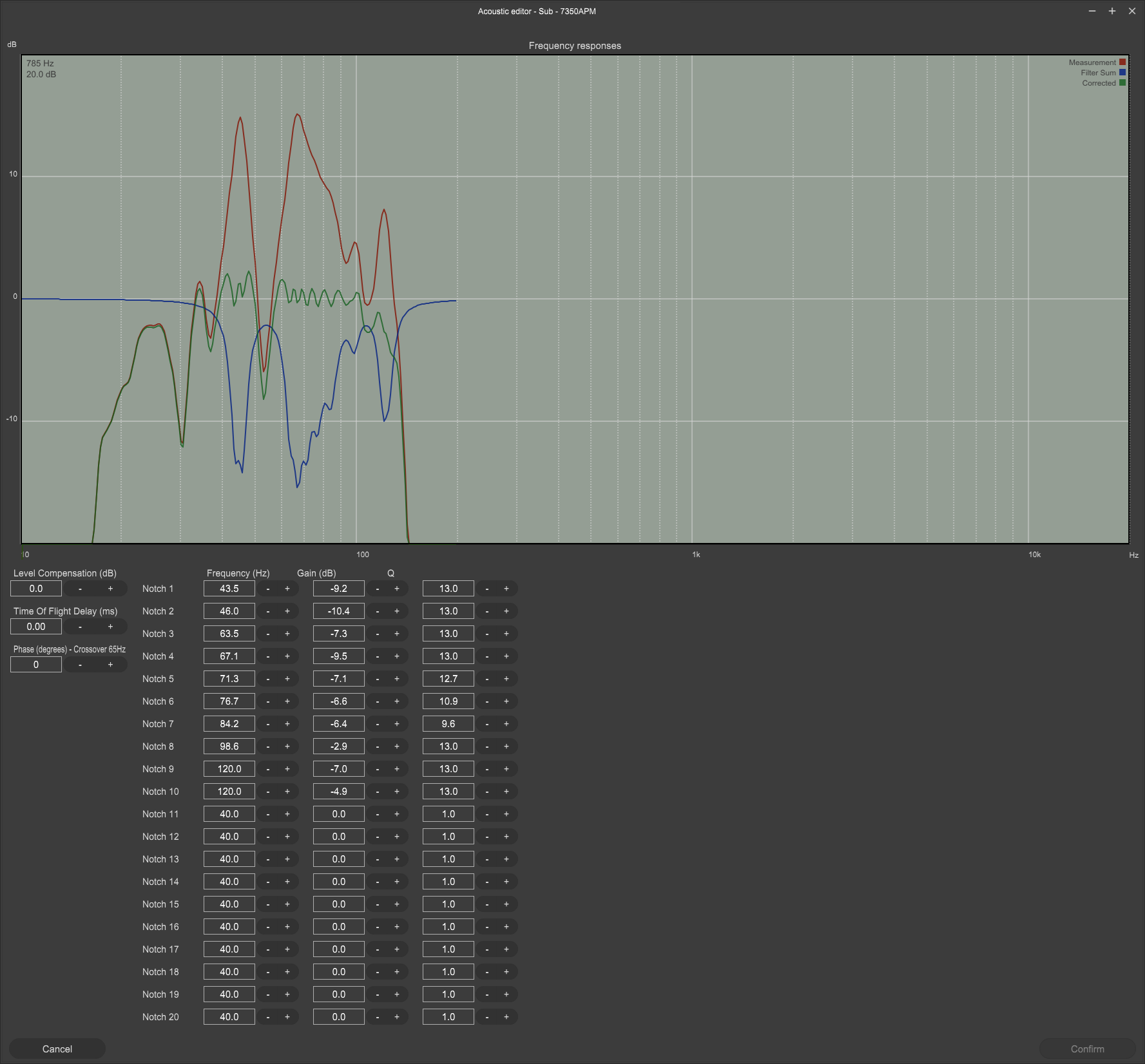

Even @Mort said his 2 x 7380A are the limiting factor in his nearfield setup with the 8361A.
@Mort can You show Your freuency corrections of subwoofer by GLM (whole table, like:
- what frequency cutt of You have? Any "bump bass", or "flat"? ... have You any manual corrections?
