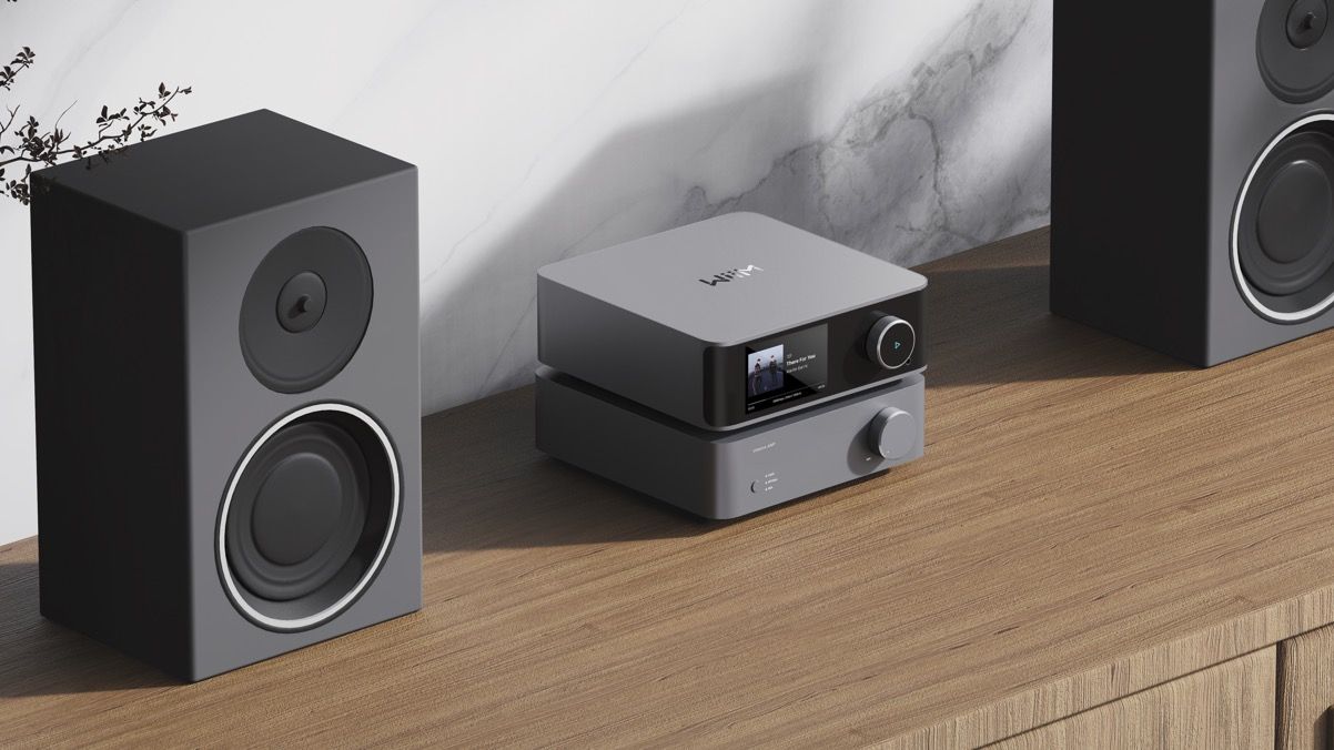

Looks like WiiM is introducing a new integrated amp to pair with their streaming boxes:
Short on details, but clearly the form factor matches the Ultra preamp. From the previews:
  • No streaming capabilities
  • 100W/channel (8 ohms) amplifer
  • Analog inputs
  • Digital inputs
  • Supports variable sample rates and bit depths
  • Speaker connections
  • $400 USD
  • Official announcement in March
AFAIK, it is a streaming-DAC-less Wiim Amp to pair with their streaming-DAC-only products. :)

Just fyi, you can make out in the Stereonet photos that the front panel input selector reads Coax / Optical / RCA.
Seems like it would have been pretty easy to take the best implementation of the 3255 chip and make it a dual mono poweramp in a single case that matches the Ultra. Charge $300-500 and call it a day.
