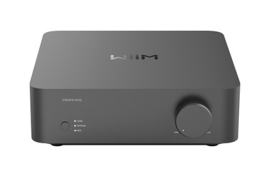

I'm having a similar issue with my Vibelink (a slight whistling sound and pulsating tapping). I contacted Wiim support and attached an audio recording of the noise. After reviewing my request, the company's engineers acknowledged the defect and offered me a replacement device, but since I didn't buy it from their official Amazon store, they didn't provide a replacement.
Did you manage to solve this problem somehow?
That's not entirely surprising - in many jurisdictions the warranty is the responsibility of whoever you bought it from, rather than the manufacturer.
@eshkilev
Sorry for the delay.
I returned the device and got another one, it's perfect, with no noise or any problems.
It was the easiest way...if you're too late to return it, please contact their customer service; they'll definitely help you; they're always very kind and helpful.

No. The Videlink RCA-in goes directly to the amp without any digitization. I just ordered one specifically for the pure analog in. I guess that wasn't a good idea. I have no need for the internal DAC, and was hoping the analog in would measure better than it did. I'll still test it with my speakers and environment.
If you notice, Amir noted that the issue with the RCA measurements were likely due to a ground loop in his setup that he wasn't able to eliminate.
I would also note that this demonstrates quite well why "pure analog" is not necessarily better.
Follow-up to my above post... After the Vibelink arrived I swapped it out where was I intending to use it. Hooked it up to the same preamp and source - all using RCA interconnects and RCA-in on the Vibe. Since I was paring it with a pre, my intent was to use it like a power amp - using the volume control on my pre. I preceded to listen for awhile with the Vibe volume control setting at 3:00. As I was listening to some of my favorite tracks, I noticed a very low-grade noise between the tracks. I was listening in a near-field situation, so my ears are only about 3 feet from my speakers. I thought to myself, WTF! After a bit of detective work I confirmed that sure enough, the amp had some hissing and cracking coming from both speakers that I could hear on quiet passages and between tracks. At the volume set to 3:00 this noise was noticeable. Even if the music 'drowned out' the noise it was still coloring the sound. I'm a real stickler for my amps to be ultra quiet, and even at full volume you shouldn't being hearing anything on a well designed amp. This was indeed puzzling.
So, I proceeded to try and track down just where the noise was coming from. I swapped out the inter-connects coming from the preamp. Still there. Tried a new power cable. Still there. Tried a different preamp. Still there. Rearranged my cables to see if they might be a factor with the noise. Still there. Relocated the amp thinking maybe the proximity to my other electronic stuff was picking up some interference. Still there. This sound was not a continuous hum, so I knew it wasn't a grounding loop, or grounding issue between components. Now I'm getting a little more worried about this amp. There was only one more test to perform.
I physically moved the amp into my shop, and put it on the bench and hooked up my test speakers. I used my DAP as the source - plugged directly into the Vibe. Turned the Vibe to 3:00 and voila! No hissing or crackling. Even with the volume all the up, the Vibe was dead quiet - at least with my ear right up to the speaker. This was good news. I then tried it with a couple preamp that I know are uber quiet, and the Vibe was still quiet. No hiss. No crackling. I guess the moral of the story is, if you experience this low-level noise coming from the amp move it away from computers, Alexa and other nearby potentially noisy devices. I also can assume that maybe the internal RCA circuitry in the Vibe may not be well shielded from spurious other device noise. I still haven't decided where I'm going to use the Vibe, so will definitely check the noise so hopefully this won't be an issue in future at a new location.
..I guess the moral of the story is, if you experience this low-level noise coming from the amp move it away from computers, Alexa and other nearby potentially noisy devices. I also can assume that maybe the internal RCA circuitry in the Vibe may not be well shielded from spurious other device noise. I still haven't decided where I'm going to use the Vibe, so will definitely check the noise so hopefully this won't be an issue in future at a new location
Interesting, I had a similar issue with the WiiM Ultra's where the phono input would pick up electrical interference from other devices. I tracked it down to an Aiyima amp PSU, but this "dirty supply" was not made audible by other phono stages I tried (via line-in to the Ultra), so my conclusion was similar to yours here with the Vibelink, in that the WiiM's shielding (phono input in the Ultra's case) was not up to scratch.
While I did track it down fairly quickly, it is odd and the first time I had heard it. In fairness, where I had intended using it was in my computer work space just adjacent to my shop area. There are a lot of 'smart' devices, and my home server rack, network switches, and power bricks in there, so maybe I shouldn't have been surprised. I have one shelf where the audio stuff is and I have all manner of cables running along the back of it, so it could be just a mix of everything that's causing the noise. I really want to use the Vibe there, so maybe I'll try and figure out the culprit and remove it instead of my new amp. :)
Edit: I did more investigating on where/how the hiss and crackle getting into my Vibe. As it turned out, the culprit was my little Ryzen-based mini computer (one of those 5" x 5" small form factor). Now I'll have to figure out a workable solution and decide how I can move things around to avoid the 'infection' of the noise into the Vibe.
Me too, I figured also, that the WIIM Ultra picks up noise very well, which I didn't had with any other preamp. Hence I bought the Vibelink and connected it via toslink - noise is gone.
Just to be clear... I only had hiss and crackling when using the RCA input. The other two inputs on the Vibe, Coax and Optical were dead quiet. I'll have to use one of those inputs and test whether or not thay can compete with other DIY and commercial ones I have. The Vibe does use a great DAC chip, so I'm sure they sound fine.
