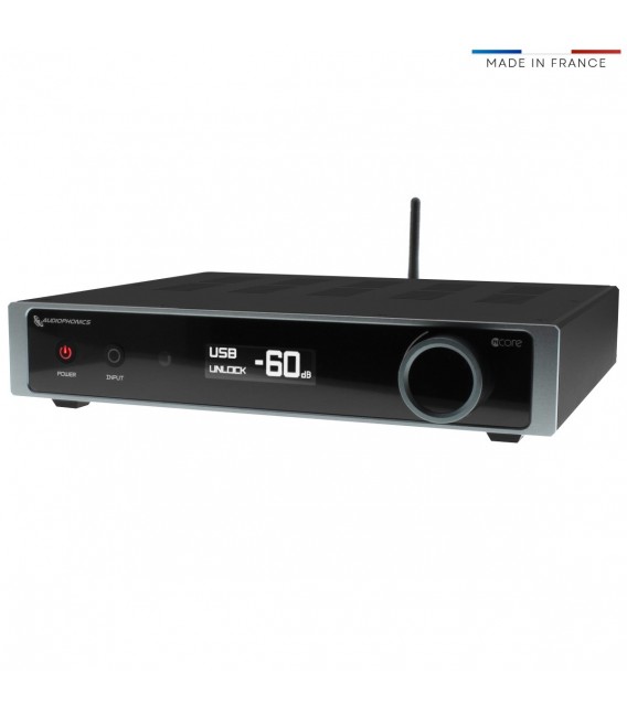

Classic approach : Its seems to me that the amp probably uses two mono tpa3251 or two tpa3255 in PBTL with PFFB combined with Cirus logic DAC or entry level ESS chip...
This makes it drive lower impedances in a better way and giving a bit more power. The 3251 BTW has a better THD figure than the TPA3255.
