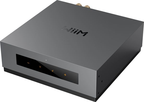

The only potentially audible improvement I think would be the lack of load dependency for the Vibelink versus the Amp. Of course, you can also just get the Amp Pro if that's a concern.
What's fascinating is that WiiM is claiming a rather substantial power increase for VibeLink (200watts/100watts into 4ohms/8ohms) over Amp Pro (120watts/60watts into 4ohms/8ohms).
Whereas Amir's test results for VibeLink:
Versus Amp Pro:
-Ed
Versus Amp Pro:
-Ed
Yes, but in a small room, near-/mid-field setup that the poster I was replying to described, I doubt that the additional wattage or resiliency down to 2 ohms would make any audible difference.
Yes, right. My response was more in general.
I think it would be beneficial, for example, in my case (compared to Amp or Amp Pro). So we shall see how the VibeLink holds up driving my LS50 Metas in comparison against my current setup (not very fair comparison whatsoever, two 400watt into 4ohm bridged mono SMSL PA200 power amps, more than twice the MSRP cost).
That's quite some difference, indeed, and I have no explanation for that. I just hope that Amir did remember to turn the volume pot to max prior to performing these measurements. I must admit that his practice of adjusting the volume so that gain falls into his preferred range is not fully transparent for me.
It may be fascinating but WiiM have been touting a more powerful amplifier since way back in Sep’23 when they revealed the two amplifiers they were developing for the CI market. I initially thought the Amp Pro might have been that more powerful model, but it appears the Vibelink now is.

Exactly. I just don't get this device. You wouldn't buy it to match the WiiM Amp/Amp Pro or the Ultra. Would you buy it instead at that price? What benefit does it being over choosing between the others? What the value proposition. Funnily the value proposition seems to be that you lose things like steaming.
For me, this is such a bizarre product that will barely sell.
Agree their first dud.
