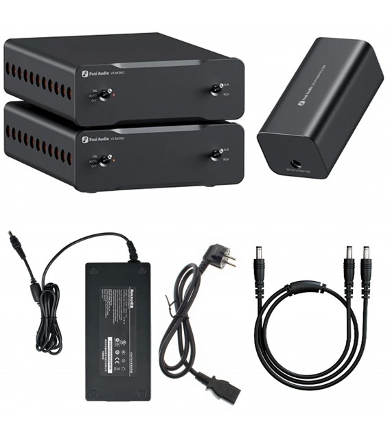

I am hesitating. Should I buy 2 Fosi mono amps or one Fosi stereo
to work with my WiiM Ultra ?

Fosi has several stereo amps in their portfolio, but I suspect you are considering V3 mono vs V3 stereo.
The mono-version has balanced XLR input (in addition to RCA), the stereo has volume control. Neither of which makes any difference if you are connecting to the Wiim Ultra.
The mono has a bit better SINAD (94 vs 88) which probably won't matter much, and quite a bit more power, which might be relevant depending on your speakers and preferred listening volume. The wiim ultra amp has similar performance. I doubt you will notice any difference between the three.

No it doesn't. I have the mono and it works fine. They have been marketed with different powersupplies, but looking at audiophonics, it seems that choice is gone. If you find different versions, I would buy the bigger one just for added headroom, but depending on your speakers, room and prefered listining volume it might not matter much.
Thank you Rolfrander and yes, I think I understand you.
With the Wiim Ultra already being a preamp/DAC/streamer,
what I need is a power amplifier only, not an integrated one.
But when you say BIGGER one, I only see one at adiophonics ?
that I would then need two of :
Yes, there seems to be only one version available now, at the bottom of the page: 1x Bloc d'alimentation 48V/5A
When the mono was announced (through kickstarter), they also had a 48V/10A version, I don't know if this is still available.
Similarly for the stereo-version, they had both a 32V version and a 48V version, but on audiophonics I only find the 48V
I can also buy this for only 90 euros extra :
to match with the WiiM Ultra
that should work. I would prefer that over Fosi (generally higher performance, and assuming you're from France, good support from audiophonics)
but as I said, could probably just sell your WiiM Ultra and buy Will Amp Ultra
I would chose that one. Especially with the 48v/10a psu bundled by audiophonics.
