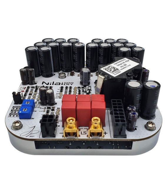

I have a pre-built Nilai from Audiophonics and am very happy with it.
Given the reasonably higher price vs. DIY, for me the pre-built version was a clear choice.
