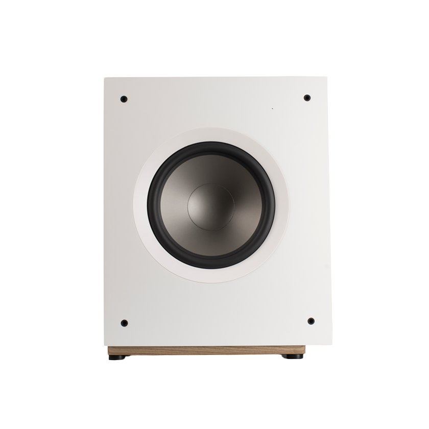

You need in room measurements to simulate *your room*. The shape of your room and the size is gonna be your biggest obstacle. Two subs will help the with room response or co-locating them will give you increased SPL. If I were looking for a small sub, I'd just build them and save money and increase performance. JAMO has a 10" that's only $125 that will give you about the same performance as the WiiM (F3 in room around 30hz). You could buy 4 and have a nice setup for music. What processor will you be using?

The Jamo is £349 in the UK.

The Jamo is Ok for small rooms (I own one for a bedroom system). I cannot believe it is so cheap.
I'm tempted to buy a few for a bedroom system at their price and shape, not to mention the "brown" color looks decent.

I have the white with the gray cloth grille and it is attractive and relatively small. I would consider it more of a mid-bass woofer than a subwoofer, but it works decently well in a relatively small room. I have not noticed it as being particularly boomy or distorted. I still cannot believe how inexpensive it is. The build quality seems to be pretty good, although it is pretty light.
Jeez, Jamo under its new ownership jacked the price of the Studio 810 to $400. That’s probably about where I would have expected it to fall—not the $154 I paid six years ago.
