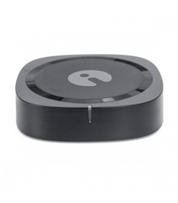

Just ordered an IEAST/Audioquest M50 with Ethernet port for about $57 from some Chinese website. Just wondering if it’s uPNP has fewer dropouts Tran the WIIM Mini.
I don't see anything about Airplay 2 or 5G WiFi support on that device. It could well be based on the older Linkplay A31 module, which doesn't appear to be bit-perfect - transcodes optical output to 48K. If you can verify, let us know after it arrives.
the old m5 or the new pro m50?
The M50. The old devices always said 24/192, but that was just into the internal DAC. Digital outputs were always downsampled (or simply truncated) to 16/48.
