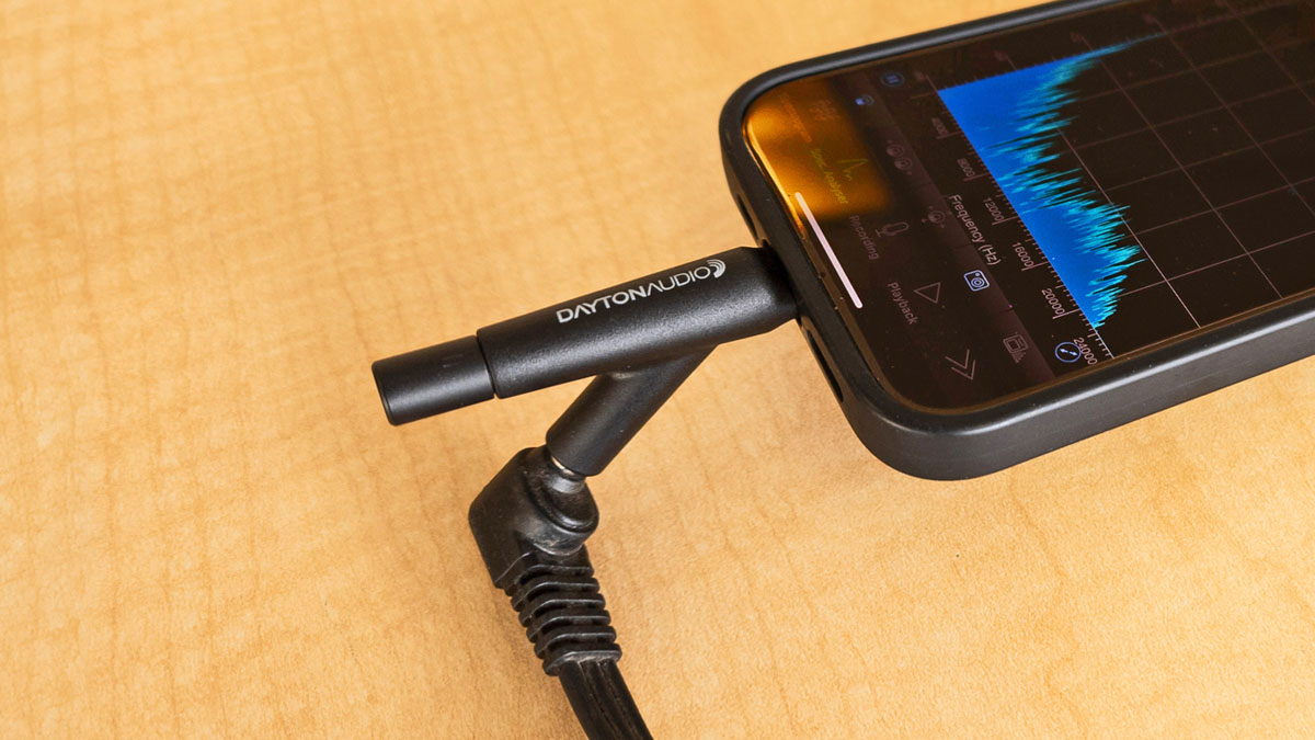

The iPhone as a mic may be the limiting factor in your room calibration. I used a mic included with RoomPerfect to calibrate. But really need a dedicated mic for to take advantage of this simple set of filters.

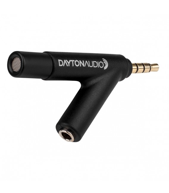

That may be the case. BUT with WiiM Mini limits settings in RoomFit , see#7 , is it worth getting an external measurement microphone?
On the other hand, a 24 Euro microphone, if it is possible to download the microphone's calibration files to the WiiM Mini (I had investigated that first), might be worth it. :) :
That seems to be the case.
Can’t I Just Use the Built-In Mics?
What if I use the built-in microphones to do a measurement? How accurate is that? After all, Sonos, as an example, required using an iPhone app and the actual microphones on the iPhone to measure the room and fine tune the response of its speakers, no matter where they are placed. Sonos found out that the MEMS mics on the iPhones are so consistent that they could simply create a compensation file for each iPhone model, and rely on the user’s measurements for their calibration app.
To get an idea of the difference between using a calibrated iMM-6C and the built-in mics of the iPhone 15, I ran pink noise through a pair of speakers in my listening room and measured the total (speaker plus room) response in Audiotools’ FFT package using both mic options. The phone was mounted on the end of a fully extended selfie stick and returned to the same measurement spot within about a centimeter. The responses are shown in Figure A, overlaid with the calibrated mic trace in green and the built-in phone mic in blue. The Apple mics are about 2dB “hotter,” which I confirmed with the SPL meter module in Audiotools set to C-weighting. The frequency response differences between them are most pronounced in the upper midrange and treble. How much of that difference is in the mic elements versus diffraction difference is unclear, but the overall frequency response measurement will nonetheless differ in this manner. Also, the built-in mics will give slightly erroneous SPL measurements.
For what is basically pizza money, high-quality acoustic measurement is now easy and reliable. If you have a phone or tablet with a USB-C connector, the iMM-6C is highly recommended.

Since both the Dayton Audio iMM-6 and the Dayton Audio iMM-6C are mentioned now in the thread, here's a little about their differences:
