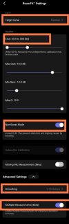

Another approach is to obtain, as you say, a microphone with a calibration file and perform a Room Fit correction up to about 350Hz and apply the Spinorama PEQ (if available) related to your speaker by combining it with the Room fit correction previously performed.
That is the method I used, with the settings attached, after some well-planned speaker positioning.
Just an FYI: Room Correction and the independent EQs are summed on the Amp Ultra. If it helps to visualize it, think of them as stacked, with RC applied first, then the independent. With the independent in this instance being the Spin corrected EQ that I manually entered.
Regarding the Multiple Measurements (Beta) option that is enabled, I made 8 individual corrections prior to testing it. The former essentially matched the latter, so it obviously didn't degrade the performance of the sweeps.
