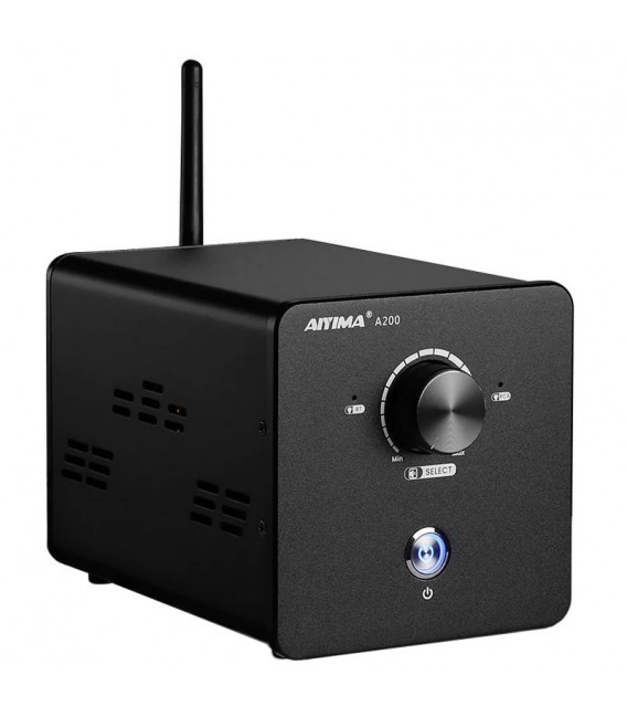

Here you go

None of these is an integrated network amplifier. The A70 needs an external power brick, btw.
