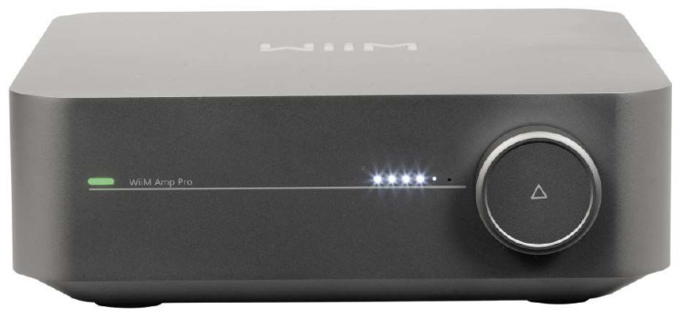

I need to replace a Yamaha RXE100 that was driving a pair of Monitor Audio Radius 90 and a sub (desktop office system).
I like the Wiim Amp Pro because of the form factor. The other choice is a NAD C 328. Will the Wiim Amp Pro (or the Wiim Amp) be able to compete with the NAD as far as sound quality is concerned? I don't care about the streaming ability of the Wiim...or the price difference.
I mostly listen to headphones, but I want to get the best possible sound when I do use speakers (when the wife is out and I know I will not disturb the neighbors). The Yamaha did a fine job for many years, and now that I need to replace it I want to find something that will be an improvement and not a downgrade.
Just wanted to get the take of people who know their stuff when it comes to amps.
Well, I just answered my own question.
I have both here with me ( Wiim Amp, not the Pro, and the NAD C 328) and I like the NAD, but I love the Wiim Amp. The Wiim blows the NAD out of the water when it comes to features (and price), but I was surprised to find out that I prefer the Wiim when it comes to sound quality (with and without room correction). It also sounds much better than the Yamaha RXE100 the Wiim replaced.
The NAD is a nice unit, but I hate that you have to turn the volume knob like crazy to increase or the decrease the volume. If both models cost the same, I would still chose the Wiim Amp.
Sometimes you get what you pay for...and a lot more.
