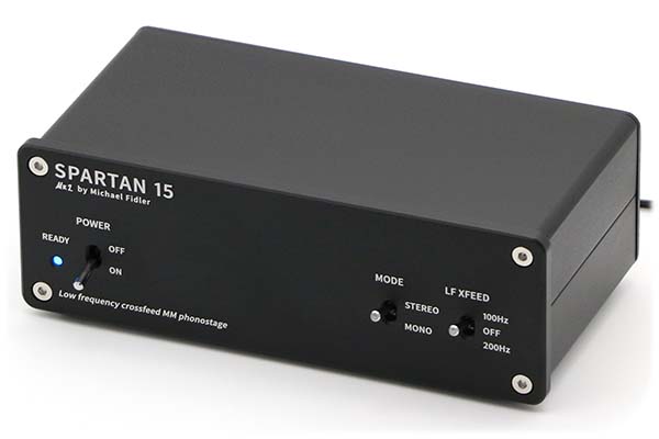

"the Spartan 15 Mk 2 is said to deliver a digital-audio level dynamic range of over 110dB"
Amir measured the Spartan 20, it has a SINAD of -81 db. And Mike Mettler review has no measurements, as per usual for Analog Planet:

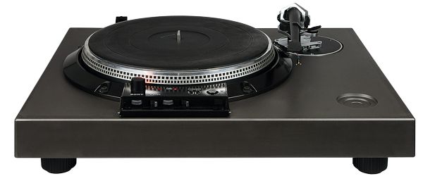

For the benefit of @WisEd I can reveal the original DD turntables we tested were excellent and after stripping to cost them my boss bought the Sony from the "scrap man" and I the Technics SP10 which was almost as good. I reassembled it and used it for some years.
Which Sony, TTS8000?

I have forgotten I'm afraid, but probably. We were interested by these first direct drive motors which even then were pretty quiet.
The 3000 was a belt drive with superior performance as tested in Hi Fi Sound in 1969 (compared with the 401, TD124, G99 and another I've not heard of since). The 8000 looks like this -

Maybe - it is 50 years ago!
I remember the SP10 because I reassembled it and used it with a SME 3009 Improved for some years.
I paid £12 for the box of bits iirc :) It had been bought in Japan before available anywhere else so it was a 100V model.
To get a quite honest figure for dynamic range (of the phono preamp), you just add the overload margin onto the SNR with the inputs connected to a low-impedance source.
Many manufacturers do this, the idea being to find the highest number possible for a press release.
