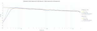

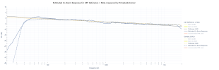

The data I recall was from Genelec 83xxA models and KEF Reference 1.
I don't see any significant difference?
