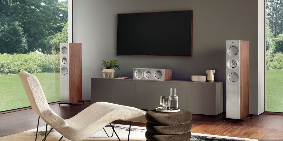

Such as previously mentioned, but if you want some examples, see below.
Dali speakers are designed to be listened to off axis.
Andrew Jones has mentioned he has designed with off axis in mind as the presumption is most customers will use this way.
Kef recommend starting with no toe in to the listener, so approximately 30 degrees to the main listening area best spot.
