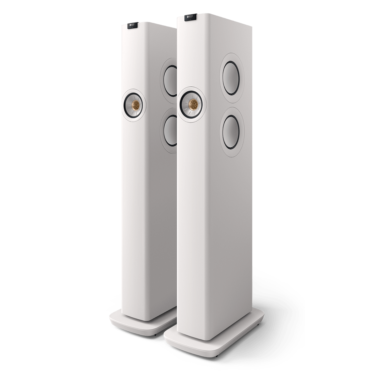

Not below US$3000, but the KEF LS60 is a real thing.

I’m expecting more from KEF as they demonstrate there is a real market. This is a great leap for those who have not already invested in separate amps, preamps, streamers, DACs, etc. For those moving from a primarily headphone based setup to a floorstander, this makes sense.

Yes, I'd love to see more. That said, $7000 for the LS60s... oof. That's a lot. You can get a lot of speaker for that much if you don't care about it being rather studio utilitarian.
