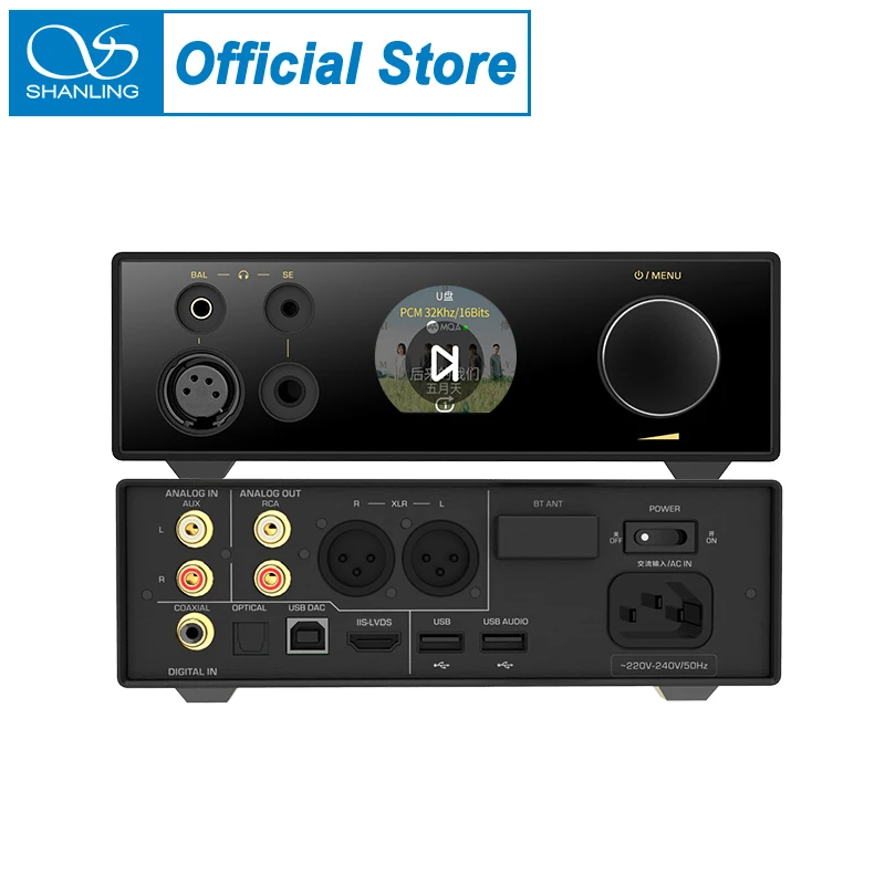

Shanling EH3, i2s/hdmi
Not HDMI input, just an HDMI connector for I2S.
5 choices of pinning for input!
Read somewhere, some use it others device!
Will post question onhead-fi!
Yes and none of them are compatible with HDMI signals.
