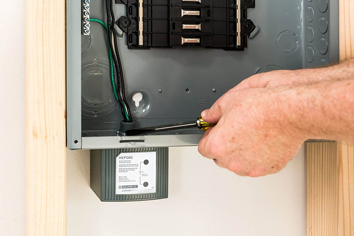

Your options are:
a) a protector mounted inside your main breaker box. This protector has too be UL listed for the brand & model breaker box.
b) a protector mounted inside your meter by the power company.
c] an after market high-tech or low- tech protector mounted next to the main breaker box.

FWIW we have two units, one in the breaker box, one outside, both Leviton and installed by our electrician when we built the house. The external one is a lightning protector designed to handle near strikes and has series open/parallel spark-gap operation IIRC. We have had several near strikes (i.e. within 50 yards of the house) and no damage (knock on wood!) The internal unit is a conventional surge protector. In addition, most of the sensitive electronics (audio equipment except power amps, TVs, computers, aquarium) are on individual UPS units to ride out short power glitches (frequent in our area) or until our whole-house generator kicks on.
Don't forget other sources of surges like cable and phone landlines. The phone company installed surge protection when we built. The cable company did not, so I added one internally before the distribution splitters. After one strike took out our cable line, they installed an external protection device outside the house where the cable enters.

For what it's worth, I've lived all over the United States, including many summers and over a year continuously in western NC. Appalachia, in contrast to places like Florida, Texas, and Alabama, seems not to be particularly susceptible to power problems.
Targeting the "prepper" market, EMP Shield says that its surge protectors can protect against electromagnetic pulses caused by high-altitude nuclear blasts. That assertion seems questionable to anyone who knows how EMPs damage things with electrical circuits.
If you are set on getting a surge protector installed, and it seems like you are, I would get one that is UL-listed (the EMP Shield products are not) and made by a reputable U.S. manufacturer such as Schneider/Square D or Eaton.
I ordered a Siemens Boltshield FSPD 140kA from Lowes for $186 less my 10% military discount. I’m not terribly worried about an EMP from a high altitude atomic blast.
