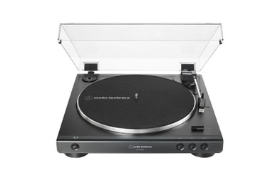

Okay, I’m not a vinyl fan at all. But I have a few old records, and my son has started to discover physical media.
To cut a long story short, I’m buying a turntable, but one as cheap as I can get away with without it being a toy.
I think I’ve settled on this:
Okay, so it has a switchable internal phono pre amp. It will be going into a WiiM Ultra, which has two sets of RCA input, one phono, one line level.
Would I be better off using the turntables pre amp and the Ultra’s line level input, or the turntable’s standard output and WiiM’s phono in?
Please and thank you.☺️

Honestly, I wouldn't worry - differences are likely to be swamped by the limitations of TT and cartridge. Using the WiiMs phono frees up the line-in for something else and that would be my preference.

Quick update - yes, I'd also consider an Audio Tecnica deck like the LP60. It's a good starter choice. If you have the option to upgrade the stock AT3600L cartridge for the AT VM95 range (E) is fine then I'd probably do that

Do yourself a great favour and buy the lp3x.
It's a little more, but the improvement worth it ... also it have the vm95 cartridge already.
In other moment you only change the stylus for the microline and ... then tell me
