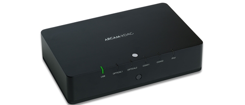

As for voltage, a random Arcam CD player gives this:
An Arcam DAC says
So, I 'd hook it up as stated in the manual, and not worry about it..
What does "nominal" input voltage mean, anyway? My guess, in this case, is "powerful enough to work".
