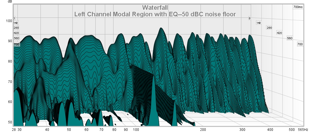

As to Fletcher-Munson, we must acknowledge that our reduced ability to hear low frequencies affects our perception of live music, not just recorded music. A tuba playing a 39 Hz Eb1 at 70 dB SPL (unweighted) (and there are several of those in Shostakovich's 5th, for example) may sound about as loud the clarinet's 990 Hz B5 played at 40 dB, but that's the way the musicians will play it if that is their objective. That's one reason my tuba has a bell diameter of 20" and the clarinet a 20th of that. The playback system does not have to provide that additional bass amplification--it's already there in the recorded levels if that is the musical intent (and if the recording engineer didn't screw it up). The playback system can produce that if it can produce pink noise flatly. The amp may run out of power on the low note before the high note, or the speakers may bottom out or compress on those frequencies at the desired overall listening level, but Revels driven by a 350wpc amp don't seem to.
Rick "easy to see the house's air handling system in that graphic" Denney
