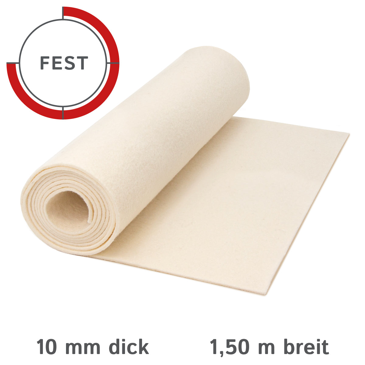

I would not use rockwhool of fiberglass today (i did in the past with good results) as they are icky to handle and make a lot of dust. I would use felt from recylced closthes like this:
Make layers of that sheet, thick enough (16 to 20cm) in a wooden frame with rough woven cloth over it and you got your own acoustic panel. You can add a painting or an on cloth printed picture as cloth cover, that won't matter much and may be easier to sell to your family than a plan clothed frame.
