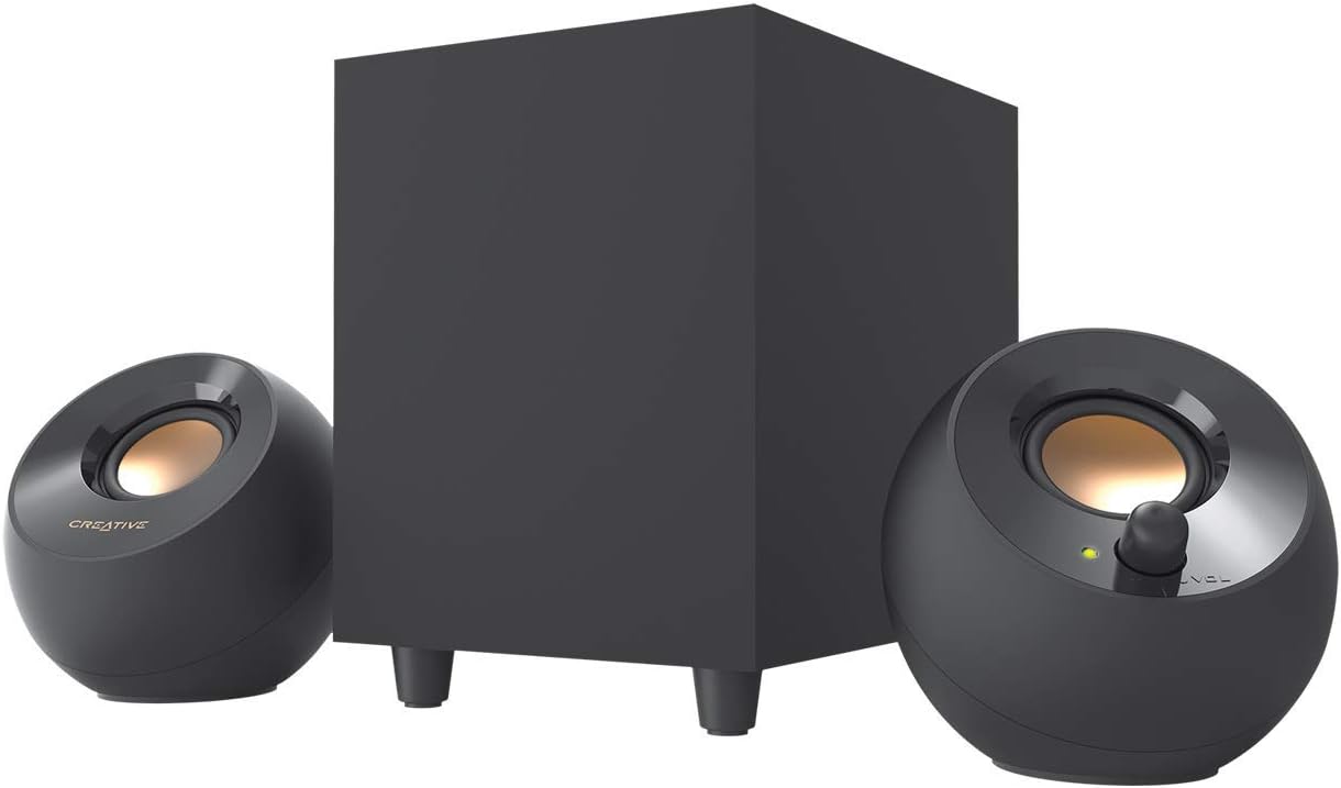

Logitech Z623, and if Pebbles v2 are already reviews, then Edifier R12u should also be in list.
