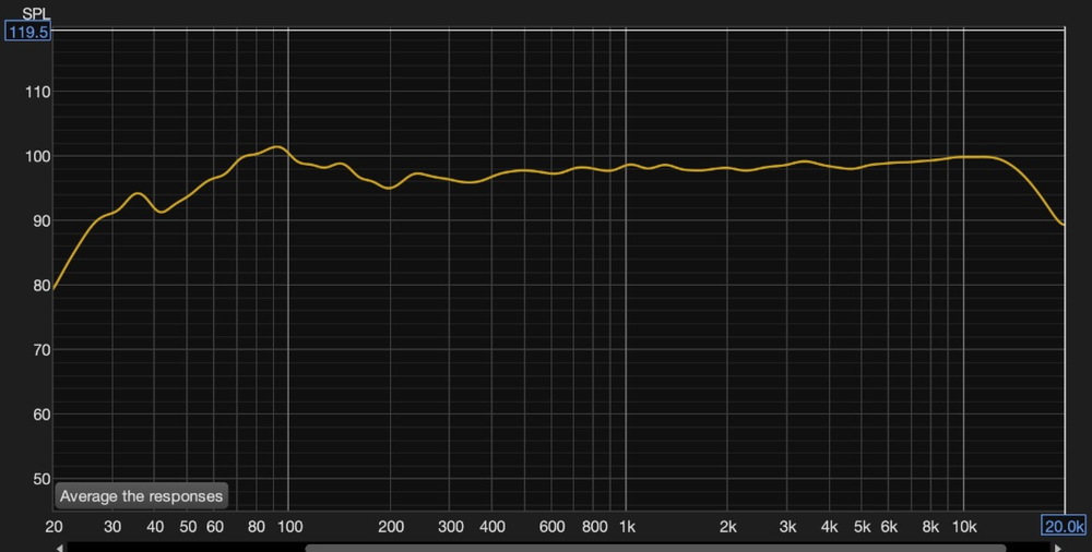

I would so like to see the AudioScience review of the Wharfedale Elysian 4's.
There is no bass under 80Hz, there are no highs above 15Khz.
Here are the measurements I did of my pair.
The two 7" drivers play well above their crossover point at 340Hz.

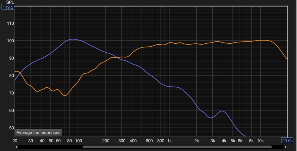

Here are the measurements I did of my pair. The two 7" drivers play well above their crossover point (should be 340Hz).
The way they lie about the size of the drivers is unbelievable.
If you measured a pair then that explains the treble issue. You need to measure one at a time to accurately see treble extension. Bass is entirely dependent on placement and seating position.
With regard to the crossover (assuming the blue data corresponds to the 7" drivers), your measurement appears to be consistent with the specification. This is a fairly standard 12dB/oct high pass filter with a 340Hz corner frequency.
If your first graph is an in-room measurement of the pair of speakers, then as others have said it has no real value as a validation (or lack thereof) of the published specifications.
Even that first graph, though, shows that the -6dB point for bass response is around 30Hz (depending on how you average or eyeball the -0dB SPL point between 100Hz and about 10kHz in that graph.) That's way below 80Hz and, once again, its deviation from the published F6 point of 22Hz is explainable by the fact that it appears to be in-room response of a pair whereas the manufacturer's specs are anechoic (or quasi-anechoic, or Kippel) measurements of a single speaker.
As for the crossover, @Weeb Labs provided the answer while I was typing this comment: your second graph appears to show the crossover point within about 50Hz of the claimed spec, and the fact that the woofers' response exists at a lower level beyond the crossover point is completely normal.
All measurements are near-field, one speaker, of course.
My in room/seating position measurements look much worse.
The reason I even thought of measuring them is because there was no bass at all.
Yes, the crossover is of the low order, you can hear 6Khz tone coming clear from the 7" woofers.
Why would they want to do that, no idea. It starts to be shouty as you start raising volume.
My in room measurements look much worse.
In general Wharfedale are not known for making up specs, so it would be best to start by double checking the measurement technique.

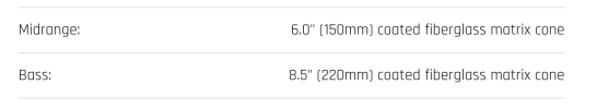

Their specs talk about cone area, they are nowhere close to being that large and there is no way they are +/- 3dB 30Hz-22Khz.

No one ever uses cone diameter to describe driver size, even Purifi who's anal about specifications in a good way doesn't.
Their 8" driver is a 6.8" in their actual specifications.
Their 5.25" driver is a 4.1".
If this was such a big deal, the entire industry would be raising hell, but it's just the standard.
False advertising is not the standard.
It's illegal in many countries.
Wharfedale specifically talks about the cone when mentioning the size.
They are showing a pretty steep bass roll-off there as well. These would be "sub required" speakers for most.
I would ordinarily interpret those specifications to mean '[size]" driver with a [material] cone'. A comma should ideally follow the diameter. As mentioned previously, the standard measurement for loudspeaker driver diameter is between the outer edges of the frame; not the cone itself.
