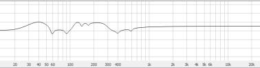

The speakers themselves (12.1) sound great, the bass reaches gracefully down to the low 40s thanks to positioning and EQ. Both the speakers and listeners are very close to the front and back walls due to space constraints in a multi-use room, which brings boundary cancellations into frequencies that are easier to treat. Room correction (made by just looking at measurements and fiddling with the PEQ) consists of a ~10dB cut from 55-110, ~5dB cut from 300 upwards, and specific cuts for consistent peaks. First reflections on front, back and sides are treated, ceiling has nothing, and floor has both carpets and a coffee table.

Someone reverse-engineered a frequency response for the 12.2 from Crutchfield SpeakerCompare; if you EQ the bass up the 12.2 reaches around 20 Hz lower (down to ~30 Hz instead of ~50 Hz for the 12.1). Otherwise the implied measurements are pretty similar. Of course this curve doesn't really show resonances, distortion etc.
it's me, yes) I confirm, in 12.2 there is quite a good pleasant bass (and I didn't even want to add it)
