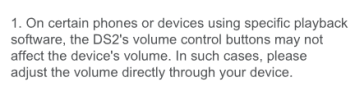

This might be a stupid question - but when you turn up the volume, do you only do it on the phone or do you do it on the dongle as well ? Android defaults to set the volume to somewhere around 50% on usb dongles.
In fact I can't turn up the volume on the dongle, it doesn't work.
It's written in the manual, it can happen
