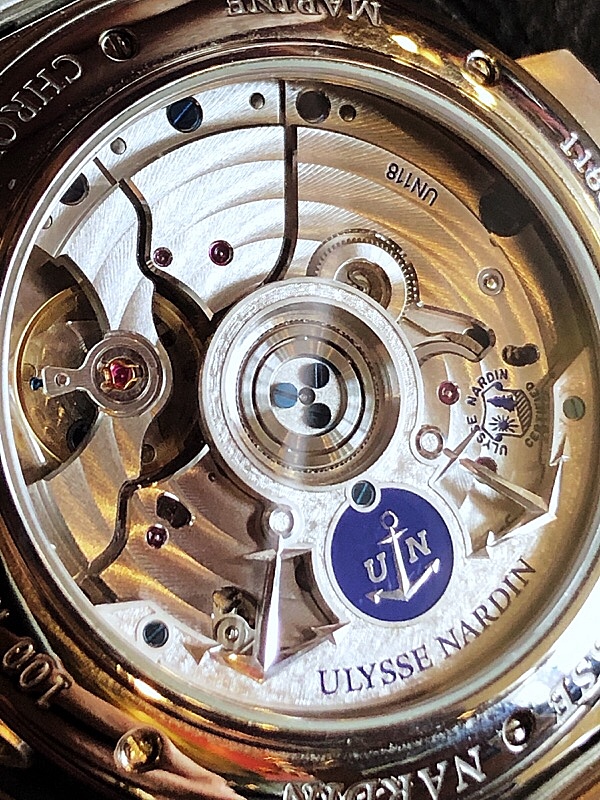

Here's the movement in that Ulysse Nardin--note the detailed finishing:
