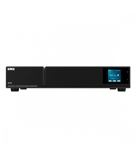

That's NOT an R2R DAC.
SMSL's RSR DAC is this one:
...which costs around 3.250 euro here in Europe.
Other than that,this multicolor,multifont screen is a total failure and the overall design and size is not great either.

The SMSL VMV D3 is even worse...

I like the look, but display styling just doesn't fit.
Something simpler even with mono color should be much more stylish and better fit for the enclosure.
I have the same impression for this and the D400 Pro. In the D400 Pro’s advertising, they showed a greyscale palette screen and would have been my preference.

That thing is so damn ugly. Truly Chinese design. And what's really absurd is SMSLs strange multi color, multi font, multi textsize display. Just something blinking is missing.
