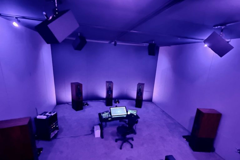

That's very good news for me, as I have little room for treatments in my room. Speaking of which, I saw your new company has a picture of its demo room in a Mixonline article. It's really difficult to tell, but there does not seem to be any room treatments obvious and several large speakers, presumably for the 5.0.0-7.0.0 you spoke of. What speakers are those?

@FrankW isn’t that a very ‘wet’ room?
The speakers are purpose built with digital zero-phase (no inversion) crossovers, each driver compensated, etc. The walls you see in the room are approximately 1' behind the surface, there's 4" of medium density mineral wool (in fireproof scrims) behind the surface, and then 8" of air space, and a triple-drywall outside that with isolation between the two outer layers, and mass sheets and more drywall on the outside.
The upper speakers have the same direct radiation as the larger lower speakers, again using digital crossovers to match things. Only difference is they have slightly less (but still quite sufficient) maximum output. Ceiling is like walls, only a bit deeper.
Ah, custom speakers. Build yourself? Sounds like a room within a room. Very interesting indeed, though I couldn't afford to lose that much space in my room! Is that enough to reduce decay times in the bass? The purple lighting makes it difficult to see, but are the inner surfaces reflective, like drywall? Or is that a thin membrane to allow the 4" absorbers to work wideband? Appreciate you sharing with us JJ, I would guess one would have to go/see/hear in person to fully appreciate. Thanks.
