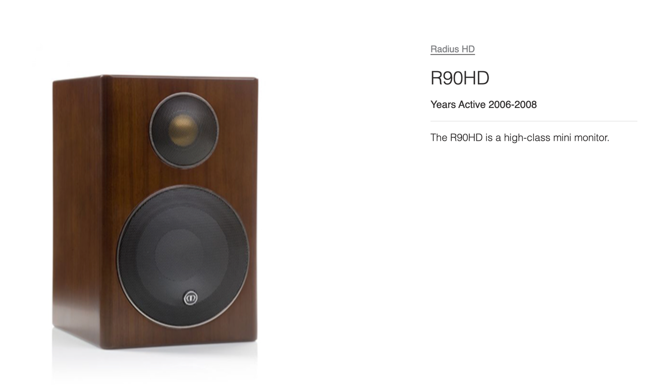

It would be the Monitor Audio Radius R90 (mahogany color)
and an MJ acoustics Pro 50 MK III (in black)
We would like to transform the above with veneer (whether or not real wood) such as the Dali Oberon 1's in light oak that we purchased this week.
However, I fear for the small Radiuses, which have 8 small corners and are very short to be able to place/finish the veneer nicely round.
The 8 corners of the subwoofer are also rounded by the manufacturer.
I also think that both speakers are not really provided with veneer but with a film layer.
Does anyone have any suggestions to overcome the short angle problem?
