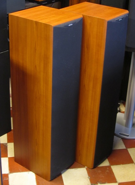

I have some old Jamo E-370 floorstanders, that could be interesting to reuse for DIY. I am thinking to replace the drivers and crossover. Goal would be to have a more linear frequency response and better power handling. I can do nearfield measurements in REW, and soldering a crossover is not a problem once the design is ready. I am, however, totally new to DIY as far as speakers are concerned. So I am wondering how I can achieve the best possible result, given a budget of say, $200 per speaker for new drivers and crossovers. I assume I would need to measure the internal volume of the speakers? What are some good drivers to look out for (soundimports.eu would be my source)?
Jamo E370​
140W/200W (rms/peak).
System 2½ Way Bassreflex
Woofer 8" /165 (inch/mm) x2
Impedance 8 (Ohm)
Total volume 60.5 (liters)
K900 x L240 x S280 mm.
8" woofer is too large for good directivity matching with a 1" tweeter. My advice is build new cabinets, add a 4" mid-range. Reuse the stock 8" woofers for bass and the 1" tweeter.
Faital 4FE32-8 is a relatively cheap driver and performs well.
Near-field measurements will not suffice, you need spinorama data for proper crossover design. Distance should be 2x your largest baffle dimension, and time gated to remove reflections.
Yes. Cabinet volume, speaker (woofer) characteristics, and port dimensions all "interact". You'll probably have to modify or eliminate the port. Get some speaker design software (WinISD is free) and plug-in the Thiele-Small parameters for woofers you are considering. That will help you to optimize the port (or it will tell you that sealed is better) and it will predict performance. (WinISD only helps with the woofer/cabinet. This particular application doesn't help with the crossover or other drivers or overall design.)

@unmutual
I might have an approach for you that would be cheaper and relatively easy to implement.
Just make it a 3-way speaker.
First, measure the two large drivers; they're about 180mm in diameter up to the edge of the rubber surround.
Then, as dedicated bass drivers up to about 300 Hz, they can be connected either in parallel or in series.
On top of the enclosure, you'd mount a cube of about 12x12x12cm - 15x15x15cm as a sealed midrange enclosure with a 10cm midrange driver.
The advantage of this solution, besides the low cost, would be the small distance between the midrange and bass drivers, with the tweeter in between.
I would continue using the tweeter for now, but there are some very good tweeters that would fit later.
You could also install the midrange driver in place of the tweeter and mount the tweeter on top, as some manufacturers do.
For the crossover, I would advise you to switch directly to an active DSP solution with separate amplifiers, using DSP software on a PC, Raspberry Pi, or Raspberry Pi Pico.
Much simpler, faster, more powerful, and cheaper to develop.

I'll throw out another potential option to consider to @unmutual : remove the existing tweeter and replacing the top woofer with a 8" waveguide or horn. That will make matching the directivity of the existing woofer easier and should keep the crossover simple. Matching the cutout may be hard with an off the shelf 8", but if you can 3D print a waveguide, a slightly larger "freestanding" one could be a solution.

Jamo E370, Original price 100 euros,
60.5 liter boxes
..weighing 12.5 kilos. Probably built with thin chipboard. Resonances here and there, probably port noise, cheapest woofers, tweeters and simplest crossover (I'll eat my hat if that's not the case). Seriously, is that something to spend money on?
@unmutual unscrew the woofers and tweeters. Measure the drivers with a multimeter. Do they measure the same? If not, skip those speakers.
Check how the boxes look inside. What about bracing?
