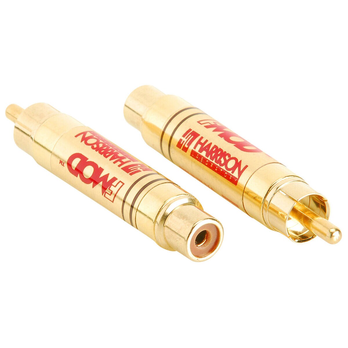

Amir recently reviewed some Harrison labs high pass filters. They also make low pass filters which may be what you've seen at Parts Express as they sell that brand. They should work for you.
They have 30 hz, 50 hz and 70 hz to choose from. I'd think you might get better results going with the 50 hz version, but don't know the particulars of your speakers.

Their regular high pass filters are 12db per octave. They also sell an 18db@37hz which I have. There's not much in music below 37hz but movies are a different story. Many subs come with speaker level inputs. Many have a crossover for the mains too.

Thanks for the info, those are what I was originally looking at. Reading the reviews, people were talking about excessive loss in sound quality and overall volume (frequencies that were not supposed to be attenuated). Don’t know if those reviews are reliable, but I initially was turned off by them.

They work fine but you need to know your amp's input impedance to be able to get an idea of what the real filter cutoff will be. Then you can use this page where they provide some info to help you with that:

Alright I won’t lie, this is a little beyond my knowledge. I’m having a difficult time understanding this link. Also is there a simple way of finding my amps input impedance?

The owners manual will often list it on specifications. Or tell us what amp you have and maybe someone has tested it.

I would just buy a few different sets, keep what works and return the others. I assume Parts Express would let you do that.
