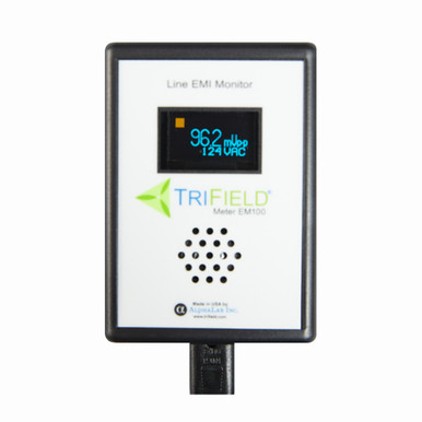

The mains noise and AC balance in my building changed completely after upgrading the building electrical intake for a higher load. noise measured with a EMI meter from Alphalabs and imbalance went down. Did not affect my hifi in any (audible) way…

This is me checking the mains noise before the change to the electrical input, After the change the noise value is about 30mV.. not 699 or 1567mV.. Please note I had no problems with my hifi before nor after
What the meter reads is probably unrelated to your problem, but anyway here is the specs
, the filters I tried did nothing to my hifi..I was just curious
What the meter reads is probably unrelated to your problem , must anyway

Probably I will get an emi meter, then I wonder what I would do with the measurements. Within the next month the Electric company is going to change to digital main meters, usually they make some continuous measurements, and I can talk with them directly.
EMI meter will only show HF not mains frequencies/harmonics.
