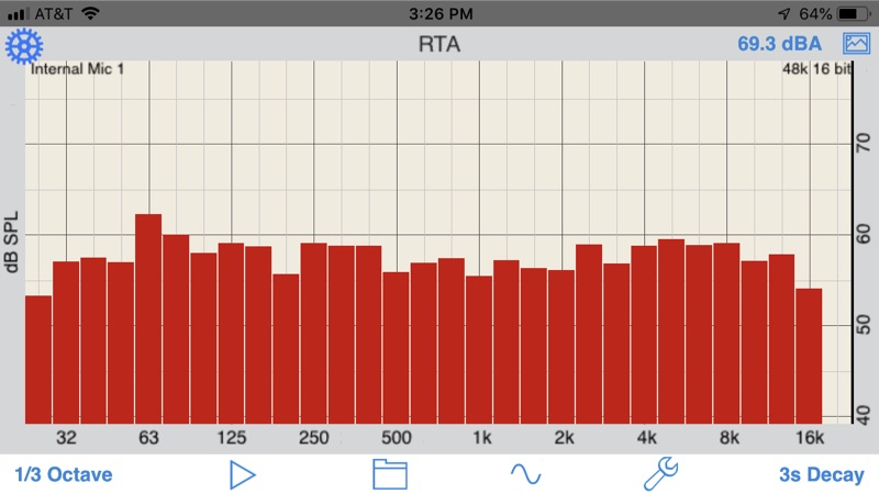

The tweeters in my Advent NLA's are a lot more than 6 months old. Maybe even more than 15 years old :)
And it may be that they can't do anything above 16 KHz any more (neither can my ears). But if the ferrofluid had hardened, the tweeters wouldn't work at all, it seems to me. And they definitely do still work. Is it doing everything it's supposed to? Here's an RTA display from prolly half a dozen years ago of my system playing pink noise. The system at that time was an SAE preamp, a B&K amp, and Advent NLA's. The RTA app is more toy than tool, but it's still data and it does apply at least broad corrections to the internal microphone.
The level shows low but the level was not calibrated. The pink noise was playing fairly loudly--maybe more like 75-80 dB SPL. Also note that the app shows the dB with A weighting in the upper right, but the display is unweighted.
The RTA graph may not show the effects of degraded ferrofluid, but the tweeters are definitely working. Those tweeters haven't been out of those cabinets since the speakers were made, and at the time of this test they were 40 years old.
One tweeter subsequently developed a tear because of a dent in the "protective" screen, and I replaced it with one someone pulled from their old Advents that probably had rotted surrounds on the woofers and were going into the landfill. (I've replaced the foam woofer surrounds on these speakers twice.)

...if the ferrofluid had hardened, the tweeters wouldn't work at all, it seems to me...
In the "final stage", yes, but it's a gradual process (which took more than a decade to become audible for me with my B&W tweeters).
They seem to deteriorate from the highest frequencies down.

Ferrofluid degrading does not stop tweeters from working but just slowly changes their response over time. Are you sure your 40 year old tweeters even have ferrofluid? I have measured loss of HF response and linearity and then changed the ferrofluid (the old stuff was quite dry and sticky compared to the replacement fluid) and there were noticeable changes in the measurements for the better / back to original specs. I also have some 30+ year old speakers without ferrofluid and the HF response looks the same now as 10 year old measurements and as the 30+ year old measurements from a magazine. It is an interesting topic I don't see talked about but if I had or was considering purchasing speakers over 10 years old and they have ferrofluid in the tweeters I would want to check to make sure the tweeters are working to spec. To me the process of replacing the ferrofluid is a little dicey, often requiring the drilling of rivets which creates metal shavings which then get into the magnetic voice coil gap, and then how much ferrofluid to you use and dealing with very delicate parts. For valuable old speakers I would like to know if replacement ferrofluid tweeters were available before I purchased them.
