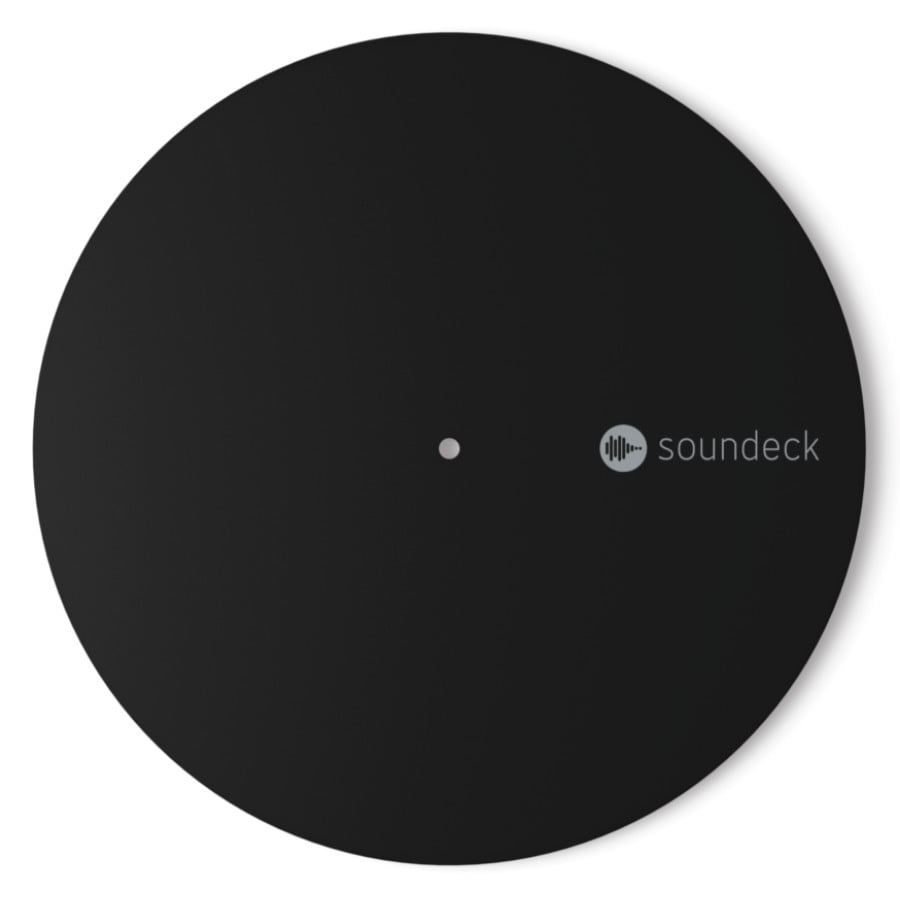

I found the idea of the Soundeck vibration isolation products pretty cool: dampened metal. I received a number of their small discs when I was checking out, vibration control for my turntable. And they were really neat in terms of how they killed vibration.
Among other things, I used an electric toothbrush to see how different materials handled that vibration, and the little soundeck discs really killed the sound and vibration.
I ended up ordering their platter mat.
You can see a video demonstration on this page from their website, which is kind of cool showing the vibration damping properties with a motor placed on and off a turntable:
I ended up with their platter mat and I did try it with some records on top. But I either didn’t hear much difference or if anything is sounded to me a little bit off. It’s pretty thick and I had not accommodated for that by changing my VTA or anything. And frankly, I just was a bit lazy about it so in the end, it turned out to be a very useful dust cover, which I leave on the turntable when I’m not using it. Plus, it’s metallic design looks better than any other mat on my big metal turntable:
