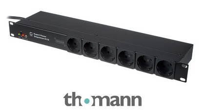

Interesting topic. I live in Germany and only found power sequencers by company GUDE, however, they cost > 300 EUR with 6 power sockets:
Quite a lot of money!
Are there lower cost solutions anybody can recommend? Safety and reliability certainly come first.
It's not only large power amps which may be problematic but switching power supplies with a high inrush current. Using cheap low cost switches or relais I am afraid their contacts could burn down or stick.
