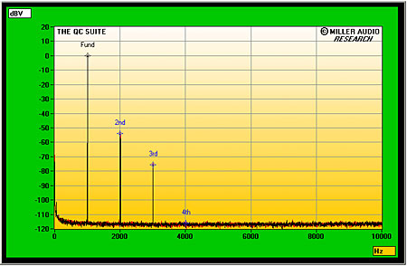

Before getting into the dashboard, here is how the stock 68HC did:
index.php
SINAD (signal over distortion and noise) is about 97.5 dB. Here is how the Raytheon tube did:
Schiit Saga Hybrid Tube Passive Pre-amplifier Raytheon Tube Rolling Dashboard measurements.png
We lost almost 4 dB in one channel, and 2 dB in the other. This is visible in the second harmonic which peaks higher with the Raytheon 6SN7.
