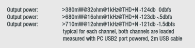

Here are measurements:
So, about 100mW per channel @16Ω regardless of which output port you use.
If you really need 500+ mW per channel in a tiny form factor, then take a look at the E1DA 9039S:

Black Pearl can deliver 1.26V in 16ohm.
EU phone 0.5V and non EU phone 1V.
Any half decent dongle should be able to provide between 1.5 and 1.8V in 16ohm.
This is enough for background music and 'normal' listening levels.
For the JT7 to play a bit louder you will need at least 0.5W (2.8V) to 1W (4V) minimum.
