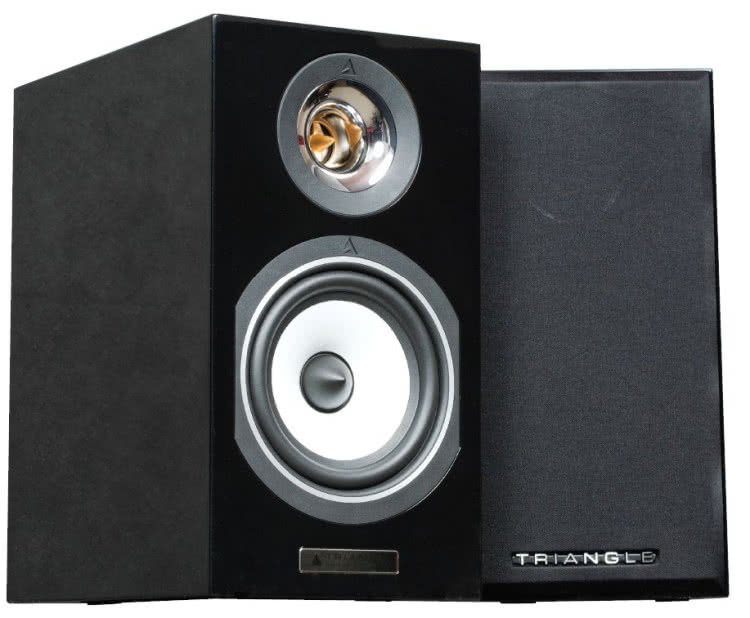

Here are some measurements of the Triangle Esprit Titus EZ bookshelf speaker.
The current price in Sweden is 8 250 SEK (853 USD) / pair (10 490 SEK / 1085 USD for glossy finish).
Specifications:
Bandwidth (+/- 3dB): 55 Hz - 22 000 Hz
Sensitivity (dB/W/m): 90 dB
Crossover frequency: 3100 Hz
Dimensions (W x H x D): 168 mm x 305 mm x 267 mm
Tweeter: TZ2500 horn tweeter with 25 mm titanium dome
Midwoofer: 13 cm ”small pleat suspension” with natural cellulose pulp membrane
Nominal impedance: 8 ohms
Minimum impedance: 3.8 ohms
I couldn’t find any recommendations for listening height, but I got the smoothest response 30 mm below tweeter axis, so that’s what I used for the spin (comparison is attached for those who are interested).
