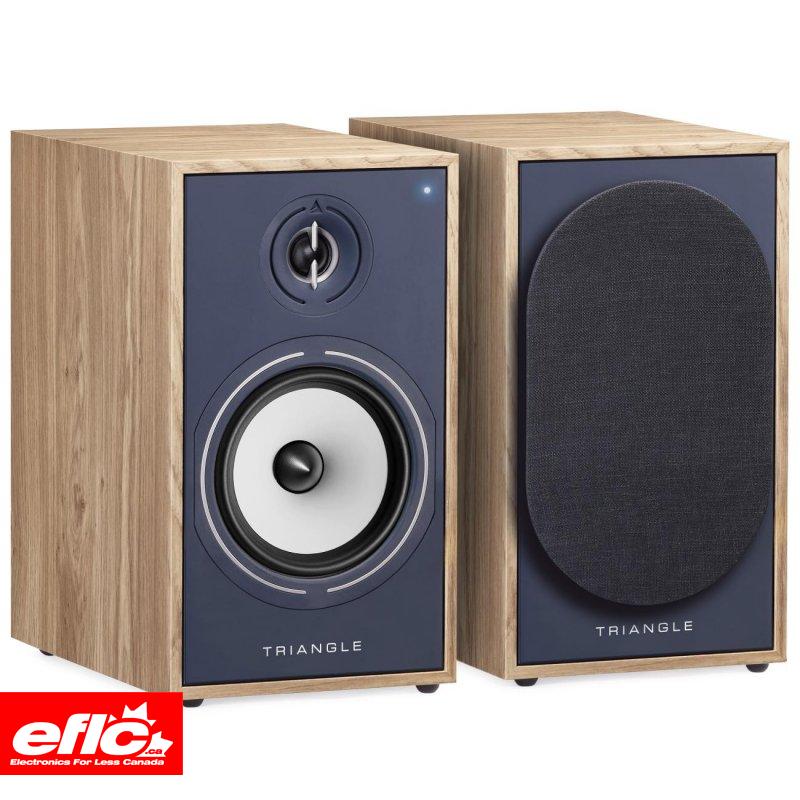

Interesting I can’t find this product listed yet on the Triangle site but looks like powered versions are coming. I think they used BR02 pictures for all the listings
On this website they have a BT version of the BRO2 or BRO3. There is a diagram with I/O.
https://www.lazada.sg/products/triangle-new-borea-bluetooth-speakers-i2224442099-s12775424661.html
