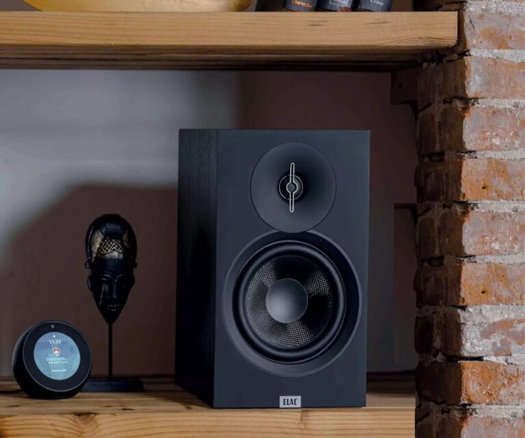

Considering upgrades for my LCR and trying to decide on a smaller tower vs bookshelf with 6 inch driver (Elac db63).

Ok that is a very different question. The DF53 has 3 5.25" woofers. The area Sd is the radius squared * Pi, so guessing the effective diameters I would say the DF53 has about twice the total membrane area compared to the DB63.
They are specced similar with regards to how low they go and how sensitive they are.
All else being equal I would say get the DF53. But if you have subwoofers anyway that will take the low frequencies away from the speakers, I think the bookshelves will be good enough. What you buy with the towers is the ability to play low frequencies loud, but this is not something you require since you already have stuff that can play low frequencies loud.
Found some measurements for the DB63:
They don't have a lot of volume below the upper bass hump, so I would cross these over more like 100-120hz. If the subs are close to the speakers this can work, if they are not you might have localization issues. I guess if you ignore the bass hump and assume the normal sensitivity....what is normal sensitivity. These are nowhere near the claimed the 87dB?
