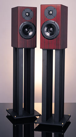

This is a review, listening tests and detailed measurements of Totem Acoustics Rainmaker Speaker. It is on kind loan from a member. It was released back in early 2000s for around $1,000 (pair):
The look and feel of the speaker lands in "good" category with nice use of wood/veneers which you don't see often today in small/budget speakers. As you may be able to guess, this is a rather small speaker which brings challenges usually in the form of dynamics. Not much to see on the back:
If you are not familiar with Totem Acoustics, the brand is the darling of Custom Integration channel. Company founder and designer, Vince Bruzzese, is at seemingly every show, putting on great demonstrations. Website and show booths are covered with pictures of models which I am sure helps with the male dominated industry they target. Recent claim to fame has been crossoverless woofers but I think this one does have one.
Even though this speaker is long discontinued, I wanted to get some coverage of the brand and hence this review.
Testing was performed without a grill and with tweeter as the reference axis.
