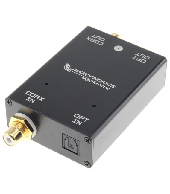

Maybe something like this would work:
This will do interpretation of data, recover the clock, and output a cleaner signal. You'll need an RCA to XLR cable to hook up the Genelec speaker, though.
Just no guarantees, this device may well have the same issues with the TV's output as the speakers..
Thanks for that - but since the Toslink sent to a Marantz receiver has no problems I do not think that the problem is with the TV's output.
