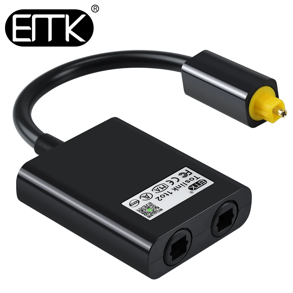

you can actually just shove multiple outputs in one input with a Y cable with TOSLINK as long as the ones not playing are not on.
And also you can get toslink to spdift if you only have one Toslink and one Spdif
EMK-Digital-Optical-Splitter-Audio-Cable-2-Way-SPDIF-Toslink-Splitter-Cable-1-input-2-Output.jpg_Q90.jpg_.webp
SPDIFToslink-Digital-Optical-Audio-Toslink-Splitter-Cable-SPDIF-Optical-Splitter-Adapter1.jpg
