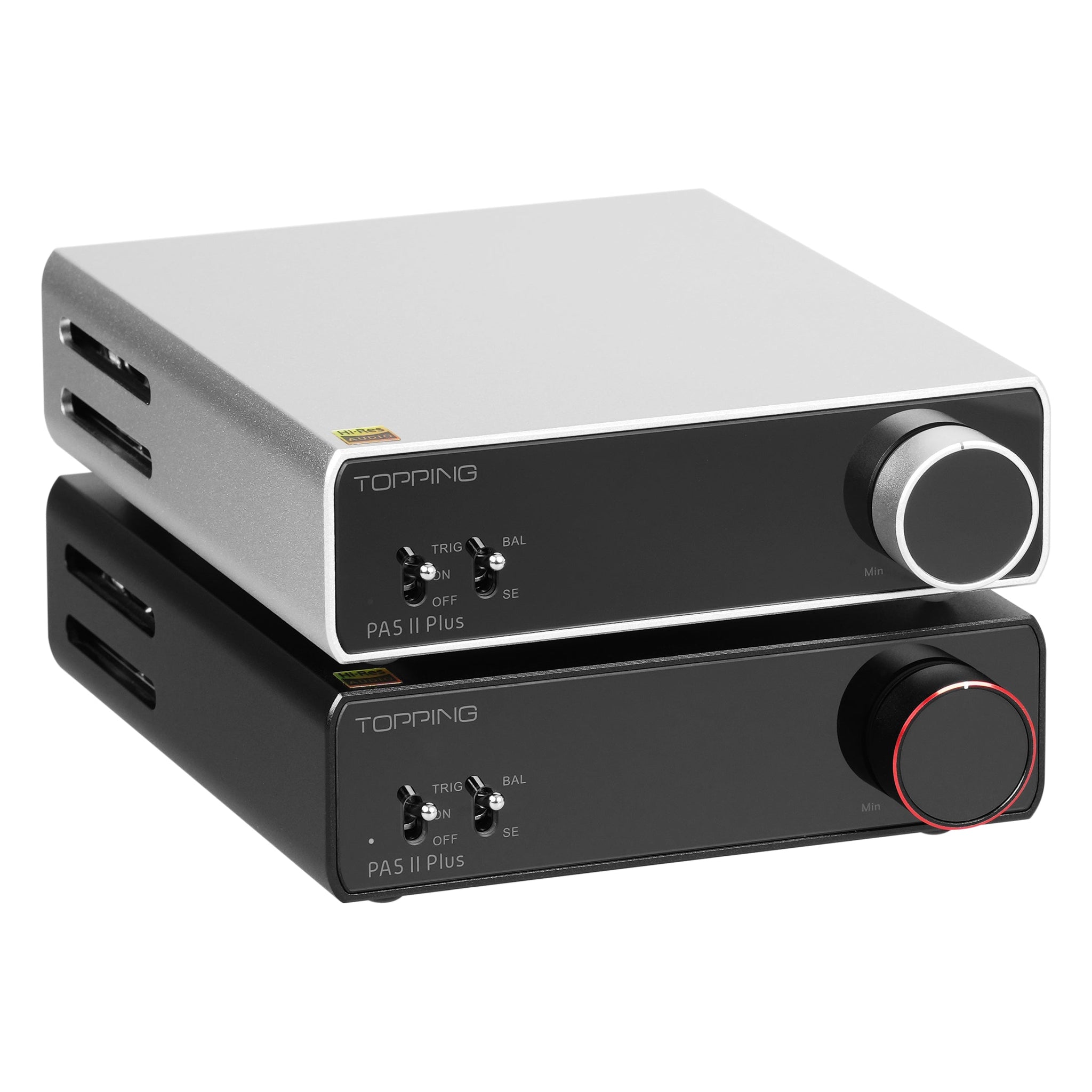

Is the old PA5 back in production? The PA5 was sold out everywhere for quite some time. But look at this:
I suspect it is an old stock, devices produced from leftover parts or refurbished devices.
Well, I wouldn't buy it.. (get II or TP RA3)
I believe the HIFIGo link you posted says it is the "PA5 plus", so likely an updated model. BTW, I still have my original PA5 working fine. I don't know if it is because it generates less heat because I changed the power supply to a 32v from the included 38v after reading the technical details of the TPA3251 shortly after purchase.
I think the PA5 was the plus version with the higher current rating on the power supply from the getgo. It was only the PA5 II that was sold with the smaller power supply, wasn't it?
pa5 came with 38v 4a (looking at mine now). pa5 ii standard is a 3a power supply, plus is a 4a power supply according to apos
So it should really be called the pa5 ii minus and the pa5 ii
that price is insane -- it's a broken design and it's more expensive than the replacement pa5ii+ by a lot
