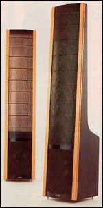

I have Martin Logan SL3 vintage speakers (https://www.martinlogan.com/en/product/sl3) very well sounding but lacking bass strenght (no matter if near o far from front wall). In other forums it's debated wether this is their weakness or rather a consequence of lack of "juicy" amplification, with 89dB/2.83V/m but a low impedence dip of 1.5 ohms.
Currently they are fed by Advance Paris xa160 - spec. here https://productz.com/en/advance-acoustic-x-a160/p/mxrdp straight from a Topping d90se via xlr interconnets at 5.2V, never used higher than -30db attenuation for my ears health's sake.
Moving the xa160 to a second system would a Topping pa5 purchase an upgrade?
If not, would 2 combined pa5 (used as monoblock - if possible - or bi-amping woofer and electrostat separately) be?

I can't find the sensitivity spec. or gain in Advanced Acoustic's site, so I'll have to make a (educated) guess. I'll assume your speaker amplifier gain is the same as the THX standard of 29 dB. If you run your D90SE with volume setting never exceeds -30 dB, combining with the assumed amplifier gain of 29 dB, effectively your are running your combo with a combined gain of ~1x (~0 dB) maximum.
Since the D90SE's max output (at 0 dB volume setting) is 5.2 Vrms, the output from your speaker amp will also max out at ~5 Vrms, which is ~6-7 W into 4 ohm loads. Seems to me the PA5 should provide ample headroom at your listening level.
Here is the Stereophile impedance measurements.
There are a few places impedance dropped below 4 ohm. I wouldn't worry about the low impedance at >~7 kHz as the energy there with music is almost always very low. I believe the PA5 should be able to handle the other low spots at ~50-100 Hz and 1-2.5 kHz without much trouble.
Thank you for the exhaustive, very clear answer and the link to stereophile test. In all my googling for this speakers before the purchase and in setting them up it never came as a link. Funny to see that in placing them I started 4.5m far away from listening point near the front wall and ended 10cm by 10 cm at actual 3.20m from listening point, exactly the same distance of ML factory measurements. Having read it before I would have maybe started from 3.20m and spared myself a week of attempts in search of the sweet spot.
